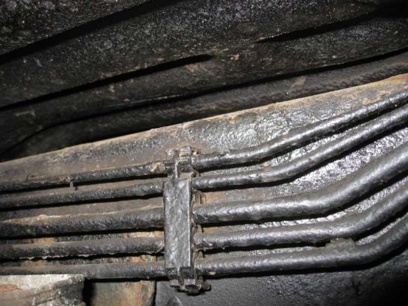

IIRR, my clips were all 5 way ones. I think there were 2 types, the difference being where the "foot" that locates over the stud was located.
I don't have any off the car, as I used what I had left, (some were down to 3 way and needed a bit of "help" from cable ties
You can just see the "foot" between the 2 thin brake pipes at the top and the thick fuel pipe. (This was before I changed them- the clips judt push ob from the front and the foot pushes onto the stud and grips.
