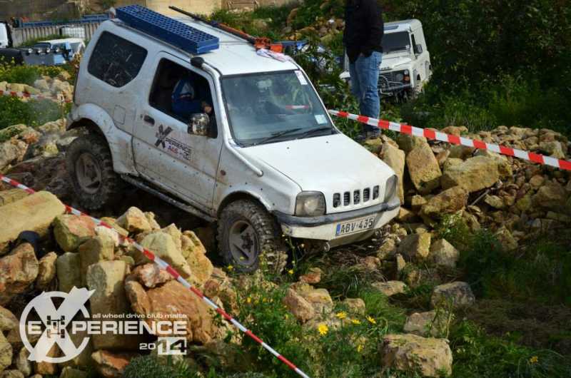

as title says after a new clutch blew it up after a 3 day comp (by the way came 1 st i was only jimny against 10 landy
i am undecided between normal or organic clutch ,i would like your openion . i have normal tcase so it is high i know but too expensive and things to do to change and after all quite happy as it is
this is the kind of terrain we compete in
comments pls need to buy one quickly pls

you really need a lower transfer box as your just going to be throwing money away regardless of the type of clutch you buy as driving over ground like that with tyres like those is not going to help.. bite the bullet an rockwatt it!..
