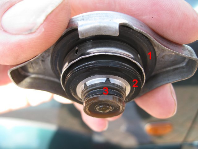

12 years 11 months ago - 12 years 11 months ago #94695
by facade
Replied by facade on topic Vvt, engine cooling problem.
If you undo the radiator cap does it pop back out?
There are 2 valves in the radiator cap.
One (2 in picture) lets the expanded hot water go out into the expansion tank, the other (3) lets the water that flowed out back in as the engine cools, looks like this one is stuck and you are not getting the water to flow back from the tank.
