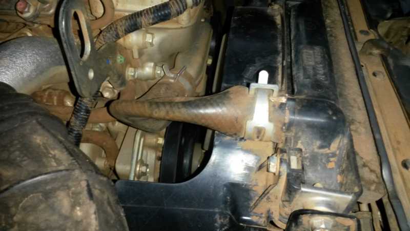

Vvt, engine cooling problem.

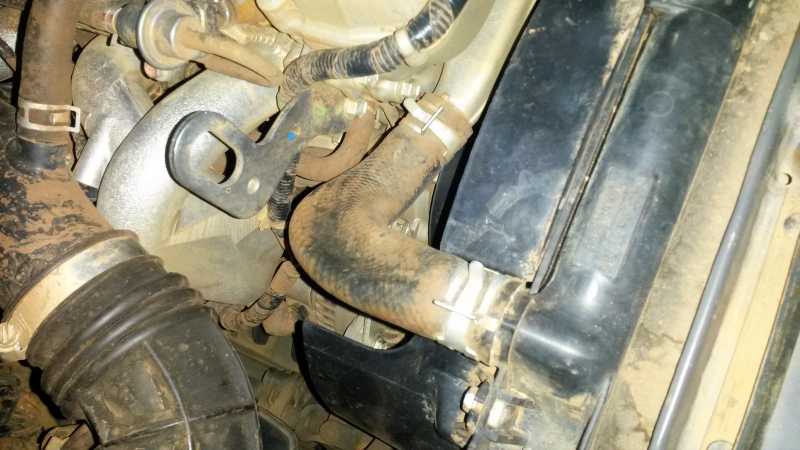

Thanx anything i can do to check it out? Run the engine and see if the pipe gets better or worse?

Also the pipe at the bottom where the water exit the radiator is also like that, so flat....
Any help would be appreciated.....

If you undo the radiator cap does it pop back out?
There are 2 valves in the radiator cap.
One (2 in picture) lets the expanded hot water go out into the expansion tank, the other (3) lets the water that flowed out back in as the engine cools, looks like this one is stuck and you are not getting the water to flow back from the tank.
