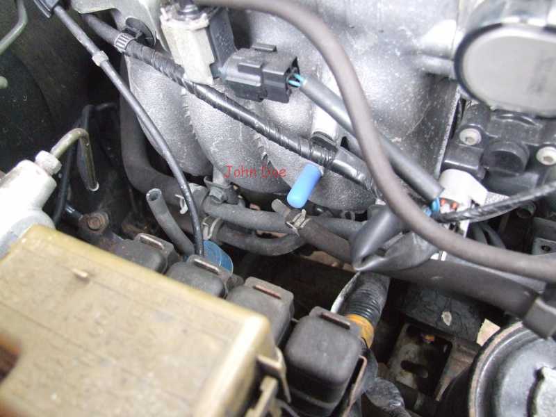

Just put some manual hubs on my '03, and can still hear the vacuum system trying to engage whenever I put it into 4x4. I know that the recommended way of doing things is to blank off the hoses, but was wondering it there is a fuse I can remove to disable the mechanism that creates the vacuum instead?

If it is the sound of air you can kill that by blanking off the inlet manifold inlet.
Here is a pic of mine temporarily blanked off using a screwbolt as a bung in a bit of tube. I now have some pukka blanking plugs.

you could also just run a pipe from the point shown on the picture to the vacuum switch (one right at the bottom) that confirms the 'hubs are engaged' that way you won't have a flashing 4x4 light..
use the same size hose as all the rest of the vac pipes.. probably 3-4 mm ID. (screenwasher pipe
