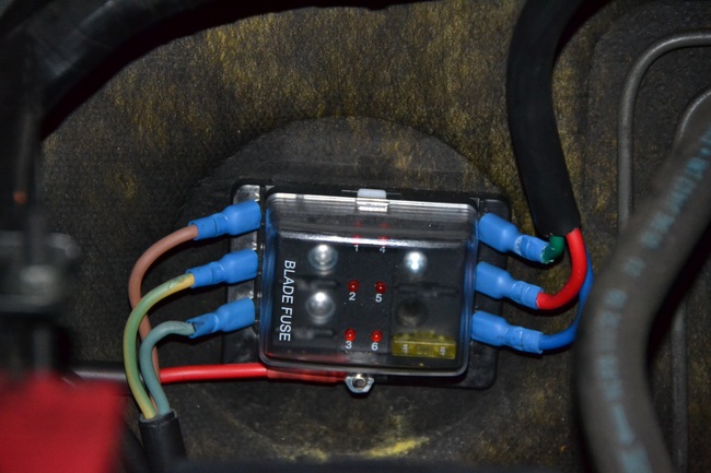

One of my projects was also a extra fuse-box near the battery.
I made it special for the bull-bar lights, claxon(s) and 3 lines goes to my switches for extra. ( rooflights etc )
The fuse-box has a led-control. I bought it by Conrad for 11 euro's.
Other photo the end of the cable's were i will install the relais.

That's nice, I should do the same - I tend to just use in line fuses as I go. :ohmy:

That looks a very tidy job .................

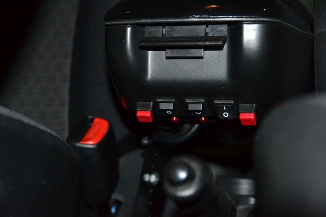

this is exactly what I am looking for! May you post a picture from the switches?
I am thinking of mounting 2 Hella Modul 70, maybe on the rear side.

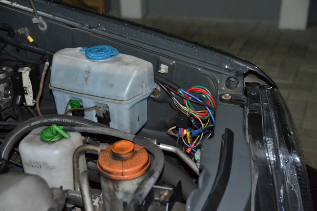

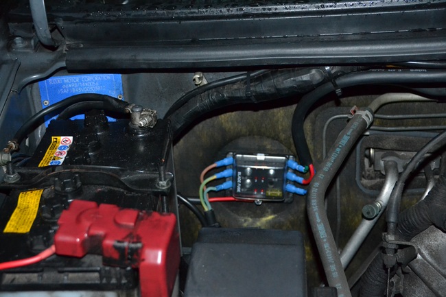

Hai Friends,
In the pictures show where the fuse-box is fitted.
And a photo of the switches in my armrest. The relais is in the front of the car.
i hope i answere the question as asked.

The place of the fusebox
The switches in armrest
The place for the relais. ( still working on second relais ( for claxon Tford horn )
