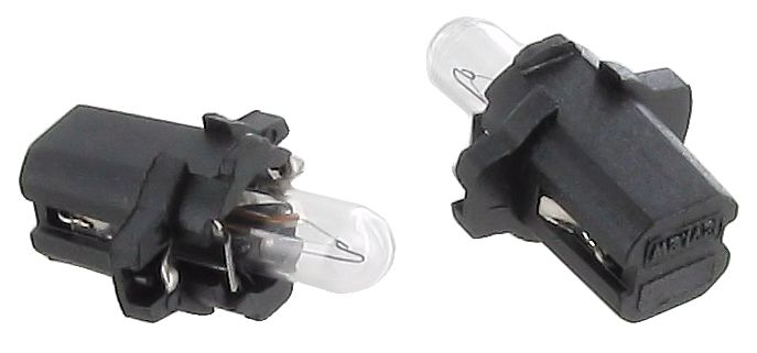

andyf wrote: Stanny,
Not sure if you've figured it out but pretty simple, once you've taken the facia off, stick your hand round the back and the housing for the switches can be un-clipped and pushed out. There's 4 clips, 2 at either end, push them in and push the switches forward into the car. Turn housing upside down and unclip the wire. You will 2 brown plastic screws, this is the bulbs, turn it slightly, give a tap and the bulb will come out.
Now only problem as they are not the ones you've a picture of and I've no idea where to get them from other than suzuki no doubt.
Hai Andy,
Thanks for your replay
I gonna try it next week, take my camera by the hand for photo's.
Will do my best. The bulbs I showed are fitted behind the cold/hot knob.
from there i changed one, it was the philips as shown.
grt
funn
These fitting are used in my dashboard. ( i search for a photo. )

Replied by andyf on topic Change defect dashlights
Nope not the same, will try to get a photo up on here.
