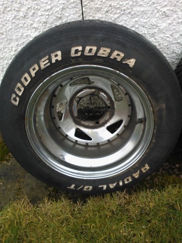

Would these wheels fit onto a jim?

Depends what the boar size is the pcd and the offset

markyp2000 wrote: Depends what the boar size is the pcd and the offset
What does PCD mean and how do I find out the offset? :) :)

Pitch Circle Diameter
Its the distance and spacing of the bolt holes a jimny is 5x139.7
You also need to know the tyre size
and offset ?
