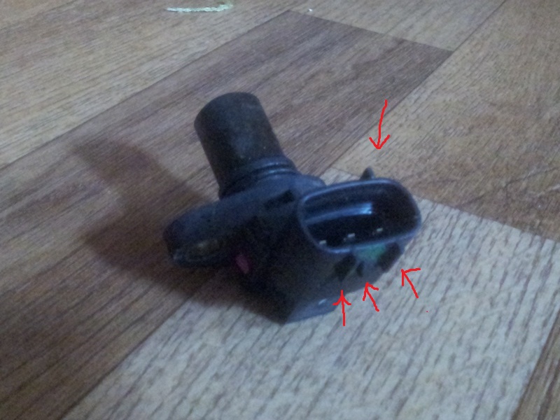

This is how the old sensor looks like:
This is how other sensors look like:
So, I don't know which parts to buy... Does anyone know some aftermarket parts which fit for sure in Jimny? They must have a connector like in the first photo, with the red arrows...

13 Mar 2013 10:03 #65530 by j999pre
Replied by j999pre on topic Camshaft Position Sensor
The other sensor looks like a g13bb one.
Use cold water to cool a sensor and see if your problem goes away. If so you will know which to change.
