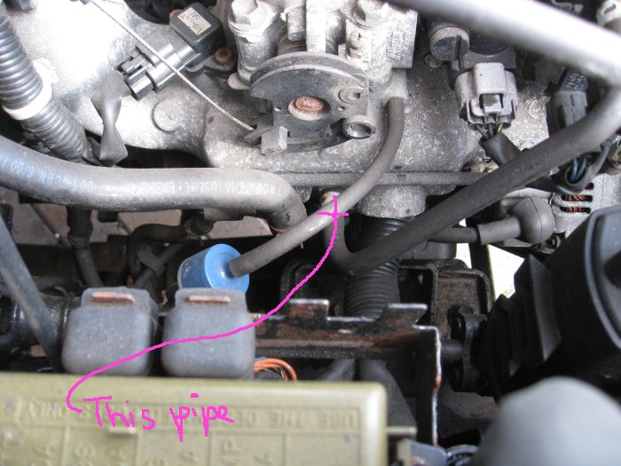

Unless the 2011 is radically different to early models, there should be a rubber pipe about 8mm diameter that goes from the inlet manifold to the vacuum solenoids under the battery that operate the hubs. Tee into this pipe.

13 Jul 2012 16:36 #44098
by facade
Replied by facade on topic Re: Where to attach a vacuum gauge?
Here is where I mean, on my X reg, the blue thing is a one way valve, so the gauge must go into the pipe that connects to the spigot on the manifold.
