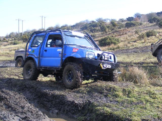

- darthloachie
15 Jun 2012 12:30 #42411
by darthloachie
Replied by darthloachie on topic Re: Warn 8274
- Bish
15 Jun 2012 14:52 #42415
by Bish
Replied by Bish on topic Re: Warn 8274
I'll be fitting mine behind a standard bumper initially.
When that gets damaged I'll build something that keeps or improves the approach angle.
The height of that 8274 is good - thanks for the pic and a tidy looking bit of kit BTW.
