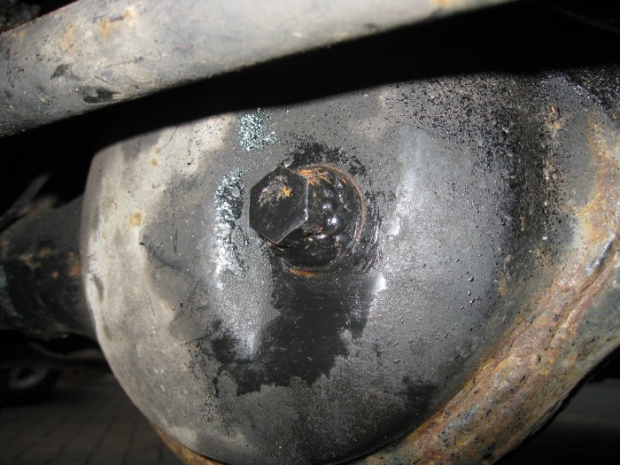

Here is my rear one:
Suzuki use a special steel alloy called "plasticene" for bolt heads plugs and allen key heads, if you give it some welly cold the square hole will become round and you won't get it out.
If this happens you can get it out with a hammer and chisel, then we weld a hexagon onto the plug and use a spanner next time.

Or you can weld a cut off bolt into the hole: just make sure it doesn't stick out too far or it will catch the panhard rod.
If you have a good mask and a garage, weld the bolt in with it on the car and it will undo dead easy with weld heat. (If you miss and weld it all to the diff you will be in trouble)
