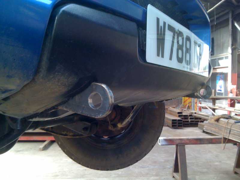

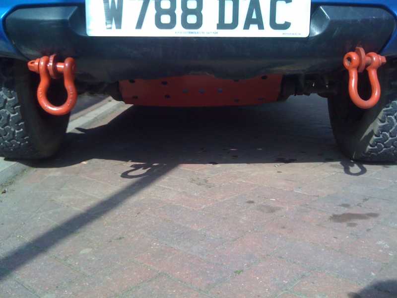

how thick is the steel 6mm plus is it
and can i make my own tow bar at the rear out of 2"box not for towing just for recovery
or do i just make a set of tow eyes a cut holes in back bumper

I ordered a weld on recovery eye from ORA and it's at least 12mm thick!
But for the rear I really should have had some thick steel plate with eye burnt out to weld to the end of the chassis rails. Sorry no pics lol

I use 10mm thick minimum for recovery and make sure its well mounted to the chassis or it will bend when you really stuck or worse still....break off

Surely 10mm is well over engineered? How thick is the steel on the chassis?
Better safe than sorry I guess...
