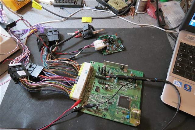

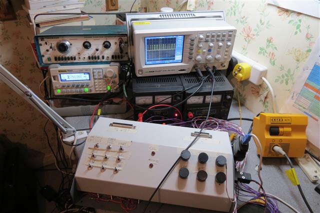

I've had a number of enquiries about remapping to suit the G16B conversion and today I finally got around to having another look at the G13BB Jimny ECU. I didn't have a matching immo so I hacked the codes to get it to work with a Baleno immo using one of my Vit keys. I've made up a new cable to hook it up to my test set and programmed my waveform generator with the cam sensor waveform and I have the ECU running.
This is the cam waveform and the injector 4 driver, pulse:
I've refitted the header for the debugger for the processor and my next step is to get that tracing so I can implement address hitting for the maps. I'm using Rhinoview to monitor the live data stream from the diagnostic port.
