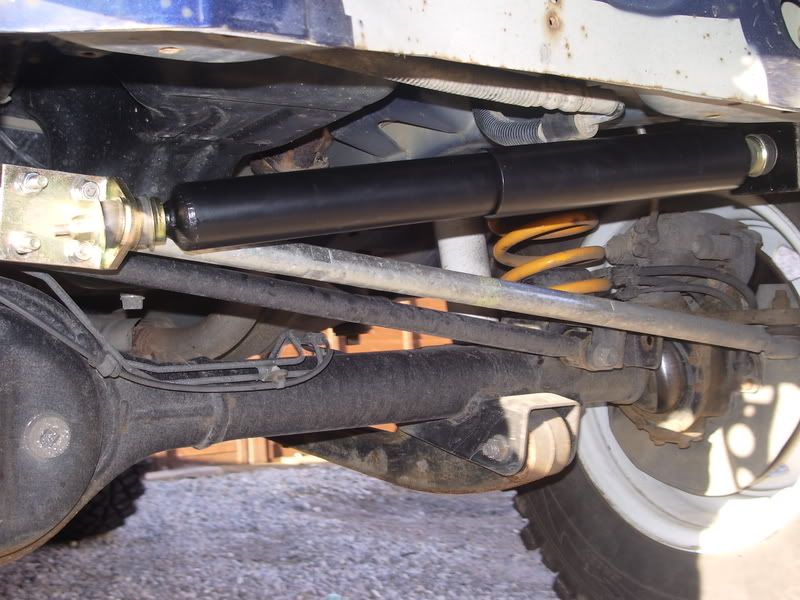

How's this for you.............

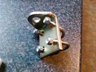

1st i bought a bracket from Dave at www.llama4x4.co.uk for the bargain cost
of £5.00

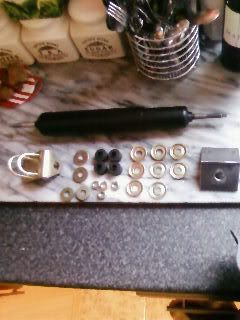

Then i ordered a Discovery series 1 steering damper from Tamar 4x4
stores.ebay.co.uk/tamar-4x4-store
Cost £17.48 delivered

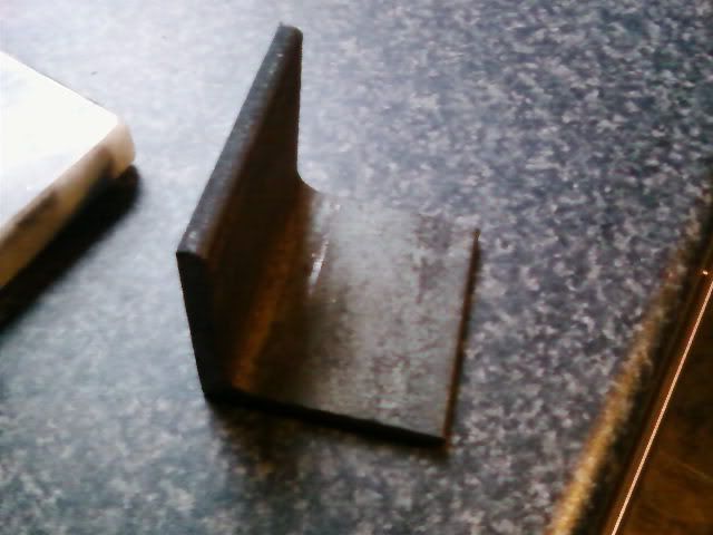

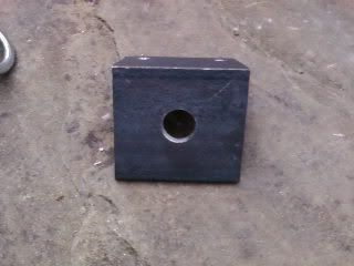

I found a peice of 6mm angle iron in our scrap bin perfect for the job
I then drilled a 16mm hole this is the correct size for the damper bushes
So now we have all the parts we'll get started

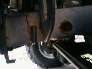

I cut off this recovery eye from the near side front chassis rail
This was left and all was ground down nice and flat
Meanwhile the bracket from llama was fastened to the steering arm close to
the pitman arm
After a few trial fittings the bracket was welded in place where the recovery
eye was
The damper was the all offered up to check all measurements were correct the masking tape shows
1. fully closed
2. Centred position 103mm
Then its a matter of cleaning up and fitting the damper ensuring everything
is nice and tight and then enjoy how your Jimny drives
Big thanks to chrisuki for all the help and cups of tea
of £5.00
the pitman arm
eye was
1. fully closed
