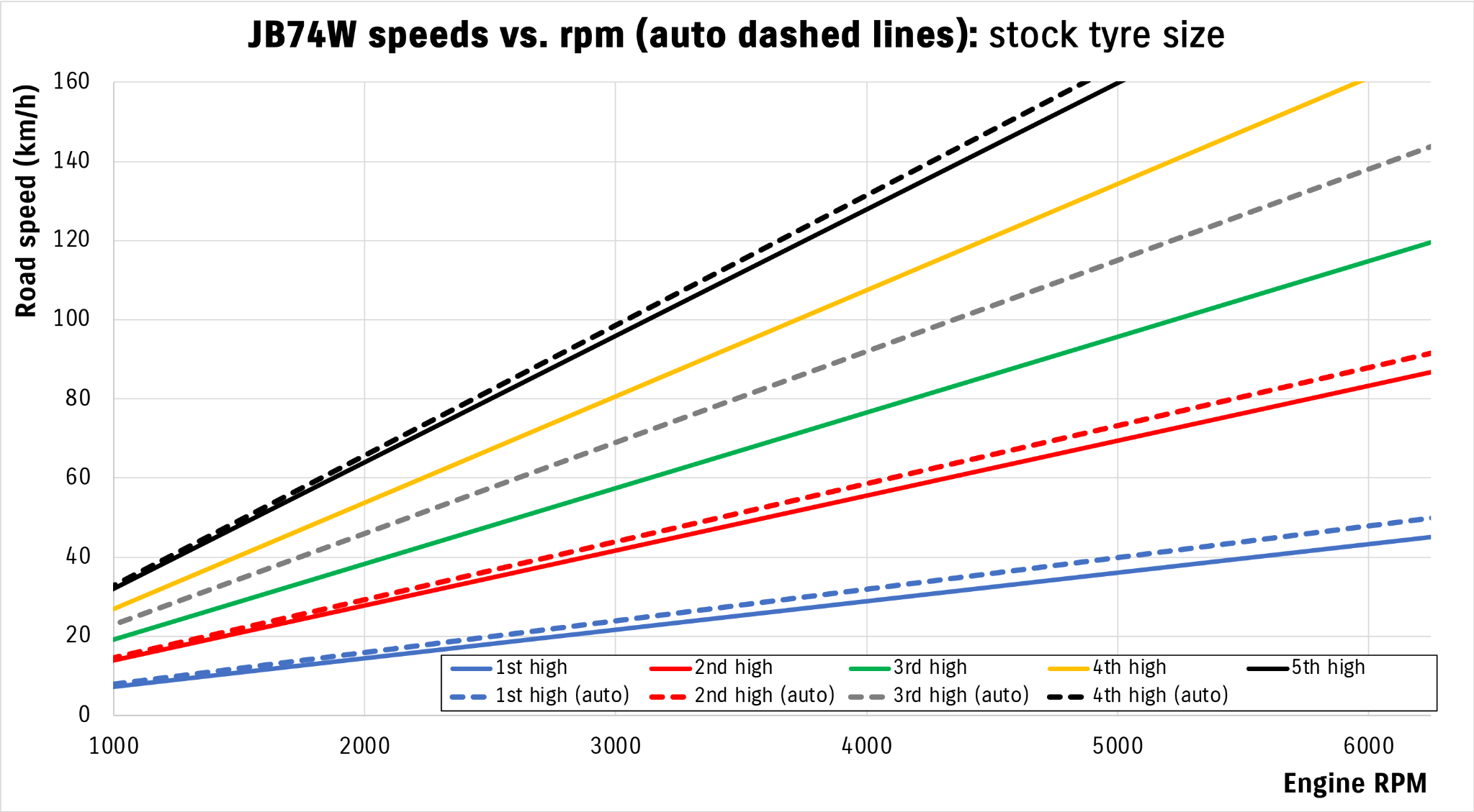

My wife & I have two Gen4s, hers is a three door with the five speed manual, mine is a five door with the four speed auto.
The manual is definitely more fun to drive, and whilst the auto is more "laid back", it is no slouch, the slightly heavier five door comes off the line quite briskly, where you might be disappointed is the "mid range" acceleration - if you're cruising at a reasonable speed and step on the gas to overtake, it's not as responsive as you might like.
This graph is from Team Ghetto Racing (link below) - you can see how first, second & top gears are quite well matched between the manual & the auto, but third in the auto seems to put the engine out of it's optimum power band.
teamghettoracing.com/vehicles/cars/2019-jimny-jb74w/gearing/
