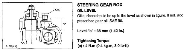

To my knowledge, the box has never been filled - only adjusted every so slightly to reduce a bit of play in the steering wheel. I understand your point, however a spill seems unlikely in my mind. Where can I find the above diagram.
