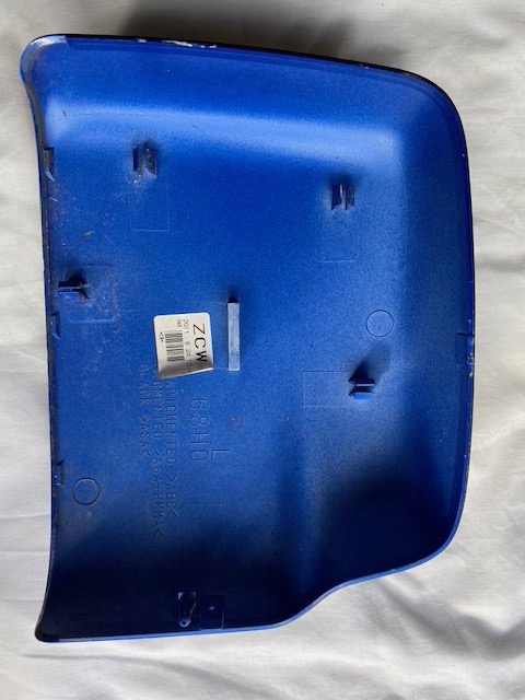

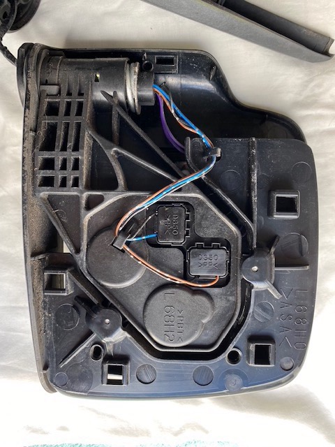

Mike has it spot on, my only advice, remove the mirror first, it’s held on with 3 nuts on the inside and much easier to do inside rather than on the car.
Pictures attached of the cover and base plate.
