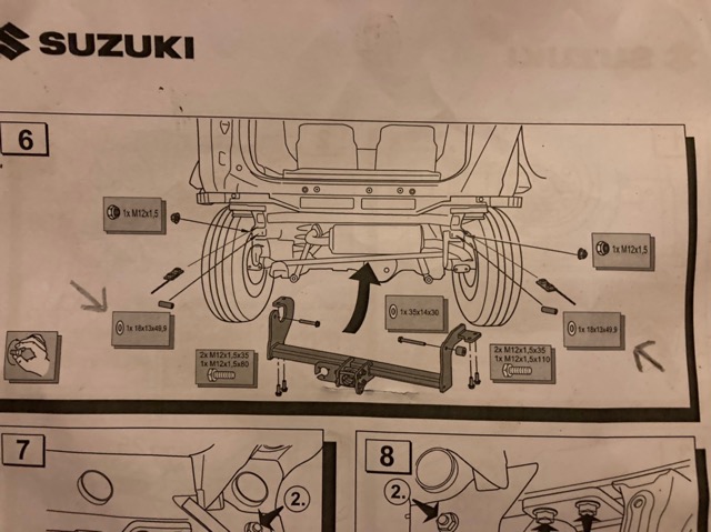

Has anyone installed the Suzuki genuine tow bar themselves, on a Gen 4?
l found an issue with the two long bolts that go through the chassis rails.
Each bolt has a spacer to go inside the chassis rail, so you don't squash the chassis when you tighten them to the recommended 120Nm
The instructions are poor, but appear to show a washer fitted along with the spacer, inside the chassis rail on the outer face where the nut is tightened.
However there is no way that this washer will fit inside the chassis rail, as the spacer only just fits and has to be tapped in.
Problem is, the holes in the chassis are a bit larger than the bolt, so when you tighten it the spacer bites into the chassis and starts to crush the metal around the hole.
In order to stop this from happening, the washer needs to be in place(between spacer and chassis)
What did l do wrong here? l've still got four washers left over.
ls the spacer supposed to crush its way through the chassis around the hole? lt would do if you tightened it to 120Nm without washers fitted.

The internal spacers have lengths of wire welded to them to help you locate them. There aren't any washers on the inside as they wont fit.. The holes in the rails have to be larger but the fit is normal.. From memory the bracket on the nearside does not have a spacer on the outside of the rail.

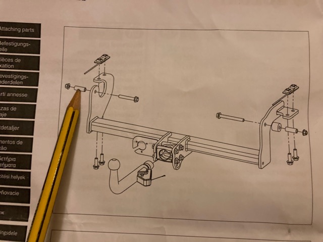

lt's the spacers that go inside the chassis rail. When you tighten the long bolts, the spacers seem to bite into the chassis.
Maybe it's designed to do that in order to make a right fit that can't move at all.
It's possible the washers are extras as l bought the tow bar second hand.
These are the spacers l am referring to, they go inside the chassis rails.

Judging by the dimensions shown in the picture the "washers" are in fact the spacers.

It appears you are correct, thank you!
It shows washers but the dimensions are that of a spacer.
l guess you just fit them and tighten it all
up, and it crushes the chassis rail by a small amount.
l must have received some extra washers, which threw me.
