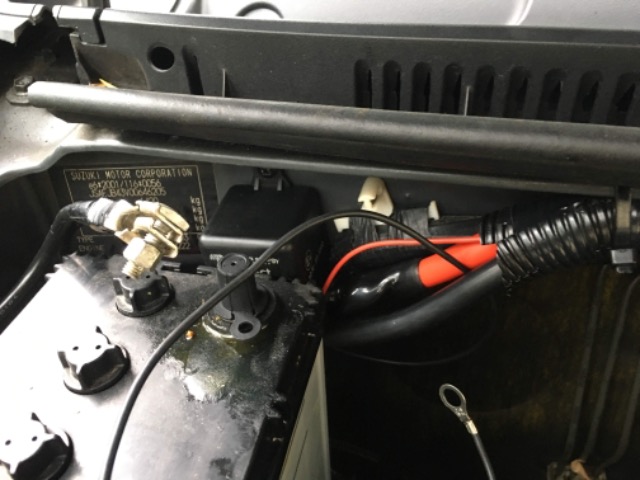

I use a Victory Energy Cyrix. This combines the batteries if the alternator is charging and the starter battery is sufficiently charged. Otherwise the batteries are disconnected to protect the starter battery from draining and allow a quick charging of the starter battery. All my additional consumers are connected to the second battery.
Make sure that:
- the wires connecting the batteries are sufficiently sized. I found that truck starter cables are the cheapest thick cables to buy. With 70A from the generator and 2m length I would use 35mm2 or even 50mm2. With 50mm2 or more then this could also be used to support winching.
- Install a fuse close to the battery.
- And for the Cyrix you need a D+ connection (alternator charging) which is located e.g., in the fuse box close to the main battery.
The additional cable and the Cyrix close to the main battery
A picture of the harness before installation
Make sure that:
