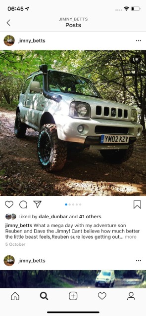

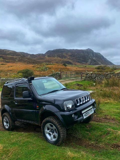

Good evening all.
I want to change the alloys that came on the Jimny, to black steel wheels.
Question is? Do I keep the current tyres, or do I change to 31/10.5/15 tyres?
I really like the look of this size in the big horn tyres with white text, but are they the best in that size?
Open to recommendations please all.
*I've ordered 2" Body lift kit and extended brake hoses for when I get home (Currently offshore in the north sea)
Here is how she looks now:-

Thinking about it and looking, maybe I’m mistaken on the actual size there !

195/80-15 has overall dia. 705mm.
235/75-15 " " " 747mm.
31x10.50-15 " " 791mm.
705 to 791 is an increase of 12.2%. As pointed out your Jimny will not be able to cope with this. Top gear will be useless, acceleration will suffer, fuel consumption will suffer, the drive chain will suffer. You will not be a happy bunny. Your photo shows your Jimny in it's element. Please don't ruin it by converting it into a Yankee look alike jacked up Jeep.
Roger
