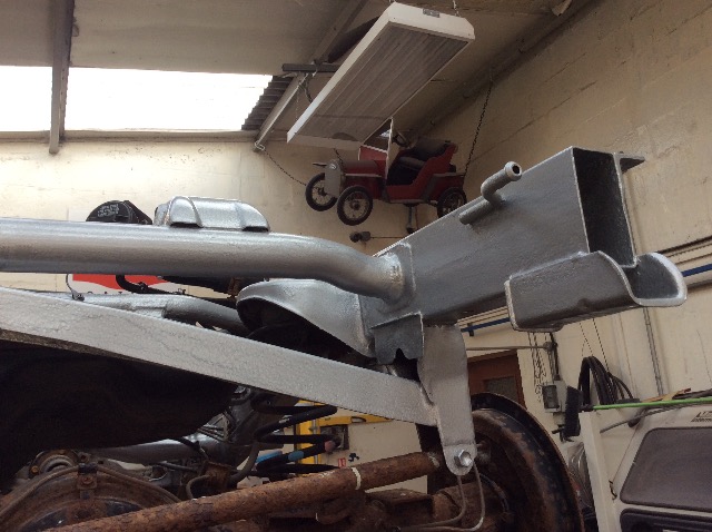

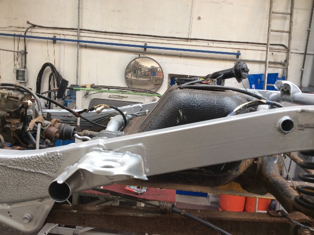

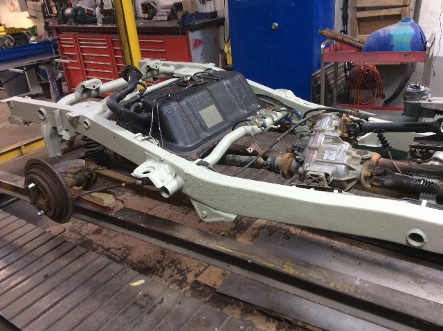

We are doing our own truck at the min and have gone for clean rust as much as we can, brushed etched and then brushed silver hamerite paint
And it’s looks good. When fully built it will be shown a coating of waxoyle and I think that’s the best any one can do

I tend to use a bare metal etch primer first applied with a spray gun where possible and brush where not .
I use quite a bit of raptor in my trade and it’s about the best I’m opinion protection you can give but very messy to use.
