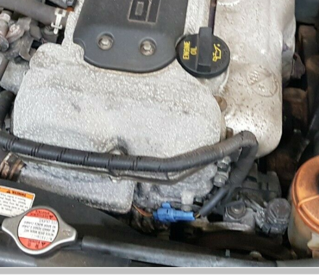

- CC Baxter
17 Mar 2020 09:36 #219974
by CC Baxter
Replied by CC Baxter on topic Camshaft position sensor location
17 Mar 2020 09:46 #219975
by facade
Replied by facade on topic Camshaft position sensor location
The VVT moved it to the back of the engine on the inlet cam (because the phaser is at the front) so the sensor is at the back on the inlet side, I think it is on the underside of the cam, forwards of the EGR valve. Left side if you are at the radiator looking towards the windscreen.
