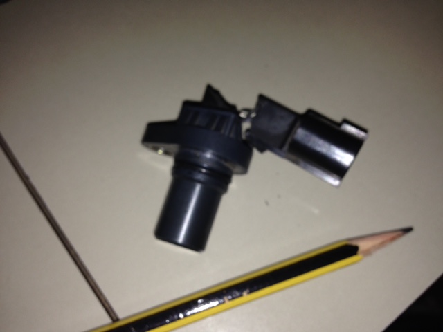

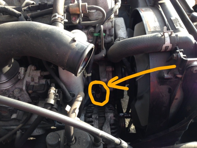

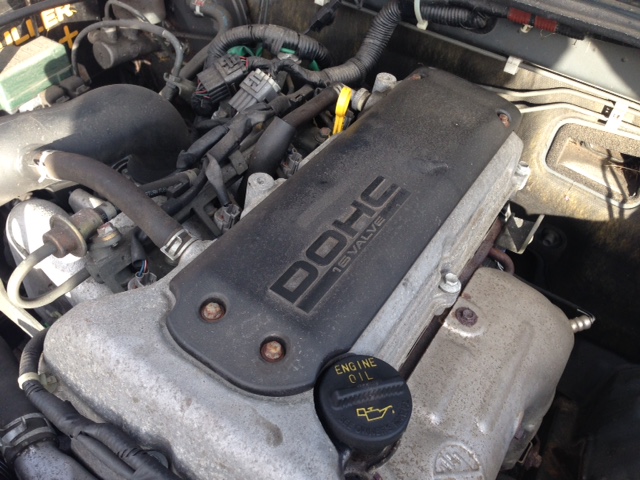

I have damaged the sensor hidden behind the alternator on my Suzuki Jimny. Q1. What engine is this? Q2. What sensor have I damaged?
What do I need to know to replace it? My local motor factors have already produced two sensors that will not fit (either too large a diameter or wrong electrical connection)

Crank sensor
You will need your V5(log book)to check the VIN number

Hi Jack
Thanks for your prompt response. VIN is JSAFJB43V00180507
Engine No. M13A-1291916
Looking at the pictures A replacement Crankshaft Sensor - ADK87203 looks to be the part.
Am I correct?
Bob

Yes i think that's correct
at bottom right there is a box(offline - leave a message)
send your info and reg number in a message and Martin will confirm
better to be sure before you buy one
