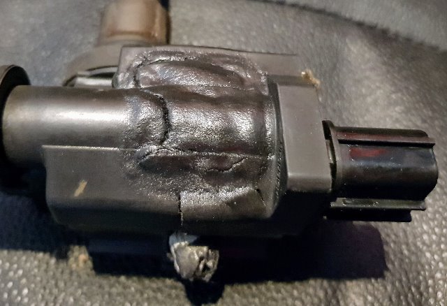

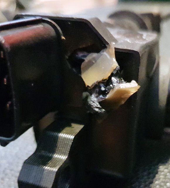

Hi
I have a problem with the coil nearest the bulkhead overheating
It overheated so bad it split and failed. Thought it was a faulty coil, but replaced its done it again.
any ideas what would course this.
Engine isn't overheating and was running great till it started missing and running rough. thought it was the crank sensor and replaced it but then while running the engine after fitting it the coil failed.
Jimny is a 2002 hardtop with the M13A
thanks
thanks

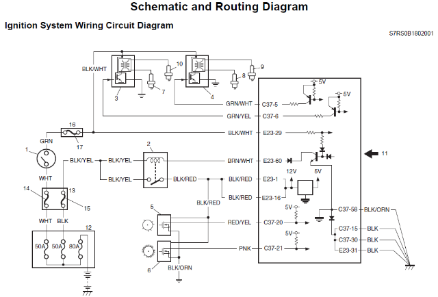

Tried to find a circuit diagram of the system in order to offer help but did not have much luck with that, so just going with some initial thoughts.

The circuit diagram shows that the power switching device (npn transistor) is integrated into the coil. It would be interesting to see if any signal difference exists between the Green/white and Green Yellow firing signals from item 11, but you are going to need an oscilloscope to be sure. They should be the same signal levels to ensure both coils are turned off/ on the same, I suppose it's possible one is not turning off fully due to a fault in the pnp driver circuit in item 11, hence no cooling period. I would have expected reduced performance (missing engine) on the coil pack if this was the case, but as with everything, not always a certainty.
That said you need a good earth on the coil pack and spark plugs within tolerance to avoid damage, and as Keithy said look for any previous owner modifications. Start with the simple things.
One thing's for sure, you are going to need a replacement coil pack! As you need to fit it you could monitor it's temperature in relation to the other coil pack, eBay sell cheap none contact thermometers. Example
ebay.us/swaBlb
It's not going to tell you what's wrong, but it will give early indication that you still have a problem rather than waiting for it to melt.
Good luck
Mike
