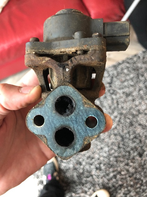

Yeah, nah that is not normal. There shouldn't be any of the burned carbon particles.

Well cleaned that up nicely looked almost new! Still no change starts up ok ish then so much as look at throttle and it just moans and dies:( throttle sensor wasn’t a fix either maybe the cat is dead.... I’ll have to get it out before it decomposes I suppose haha

I’ve not managed to try removing the cat yet but did get a video of it running and cutting out the only sensor on the intake I’ve not changed is the map sensor..took out the thermostat as that was knackered after boil test..other than cat any other ideas? The exhaust does seem to be putting out more smoke/fumes than usual and smells Rich.. also how do I post a video?!?
