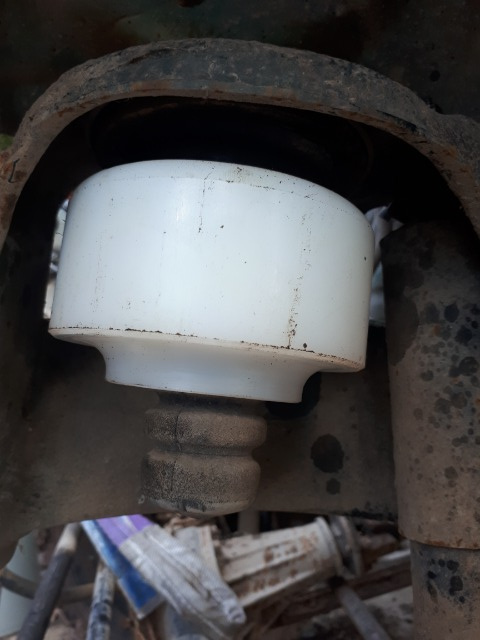

Anybody else had trouble with vitmods spring spacers? They just don't seem to fit properly in any configuration. I must be missing something
21 Sep 2018 14:54 #196177
by Jefferies
Replied by Jefferies on topic Trouble with vitmods spring spacers

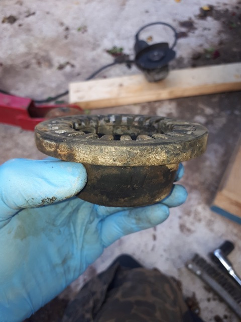

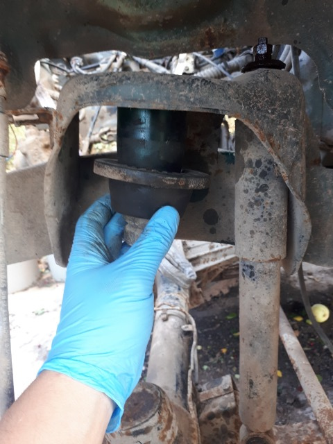

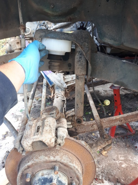

You can see the spacers aren't even 2" to begin with, but that's not a biggy.
The issue is that the spacer won't fit up over the rubber sleeve that sits around the cone in the middle of the spring.
Also if you remove the rubber sleeve and push the spacer up as far ad it goes then it bottoms put but fits so badly and is really sloppy it can't be the way it's intended.

21 Sep 2018 15:14 #196180
Replied by Lambert on topic Trouble with vitmods spring spacers
I thought they went under the spring on the axle end?

24 Sep 2018 13:08 #196240
by Jefferies
Right, I spoke to Vitmods and apparently that's how they are intended. I wasn't happy to fit something that fitted so badly so i've sent them back and i'm going to look elsewhere. Can anybody recommend spring spacers that they have actually tried personally and can categorically say fit/work well? Either that or i'll spend the extra ~£30 and get 2" longer springs
