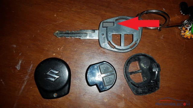

My old key fob broke so I got a new housing with blank key. Transferred the internals and got the key cut.
It will open the doors either on the buttons or the key and the car turns over but won't start?
It will still start on my spare manual key. Any ideas?

The old key will have a radio type chip moulded into the plastic, That the ignition ring needs to read before it will let the car start. When you turn the ignition on with the new key, Does the engine and imobiliser light come on?, If no try starting it with the new key whilst holding the old key tight up against the ignition cowl. If it starts you will either have to dig the chip out of the plastic of the old key and put it in the new one. Or just tape or glue the old key to the inside of the ignition cowl. But this will make the car easier for Caravan Utilising Nomadic TypeS to steal it.

So the chip is in the plastic housing?? Any clue where it is?

Moulded into it. Alternitively if you do not want to tape the old key to the igniton, cut the blade off it and leave it on the keyring next to the new key. The reader will still be fooled and not know the chip is not in the new key.

I didn't realise it was separate from the electronics and yes it was the oblong shaped chip.
