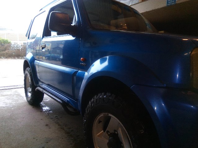

I'm running 215/75 15 on an ET0 wheel, I.e. no offset, brings them nicely inline with the arches but not beyond, so no worries with too much mud up the side. It has a 2" lift and no rubbing so far.

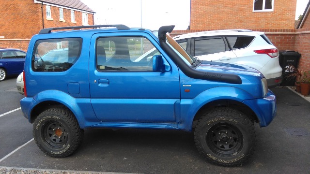

215/75/15 on standard wheels and 2" lift.
