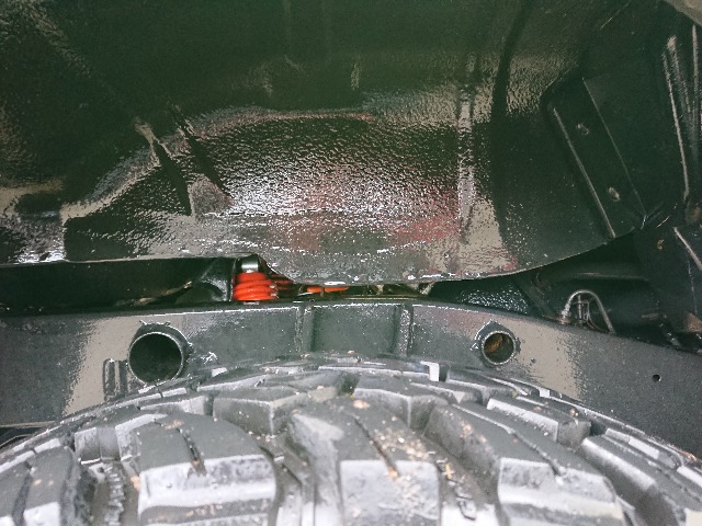

My 07 wasn't to bad but I wanted to do it any way, I gave myself about three days to do it, put it on axel stands wheels off, exhaust back box off, a good jet hose, good stiff brush, then i coated it twice with hammerite and waxoil think I done it about 2 years ago and this is it now considering I jet wash a lot it hasn't done to bad, but I have herd a lot of good things about the buzz weld.
It's all in the prep

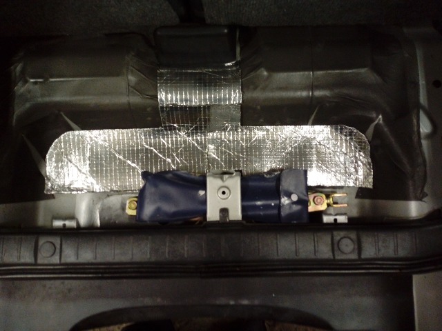

I would advise you remove the rear seats and plastics out the back
Also if you're feeling brave remove rear bumper and rear plastic arches :ohmy:

And if you do that add some more sound proofing

All of the above, holes in the boot floor in front of the wheel arch, behind the head light and all the arches are getting rubbed and kurust and sprayed
here's an extra one, check the body mounts. My one in front of the rear wheel has holes in too.
