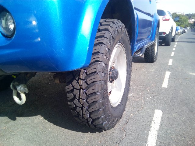

I'm running the ET0 8spokes in black on mine. Got them from
www.4x4tyres.co.uk/
great service and seem to be a good quality wheel, although probably the same one from wherever you buy them from :lol: :lol:
Also running 215/75 r15 with no bother and no lift yet - Jimny currently in the garage with the lift kit being fitted ready for next weekend hopefully.
The tyres are pretty much level with the arches so shouldn't be an issue come MOT time :whistle: , no rubbing even at full flex. not the best angle but this is what they look like on mine if it helps.
