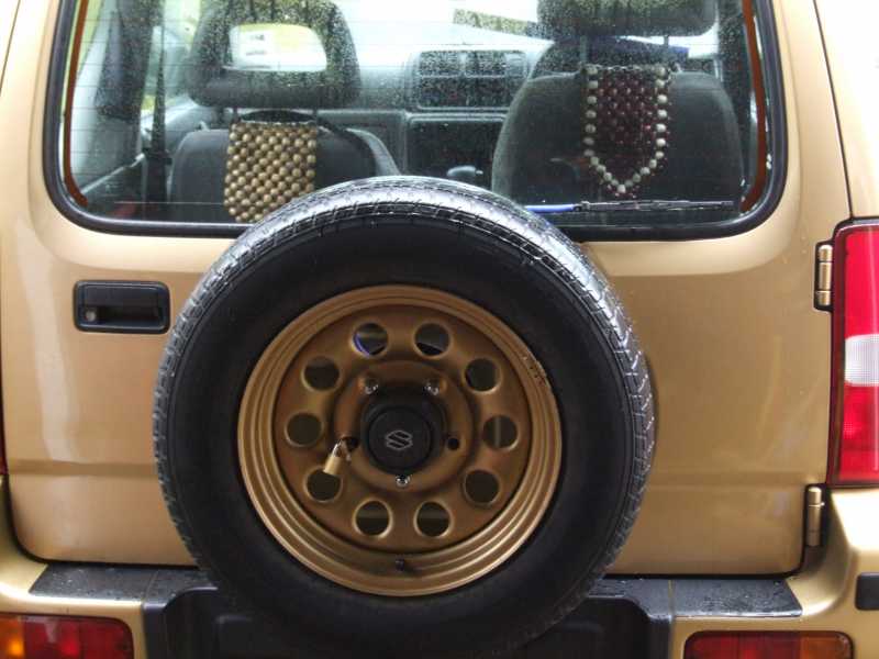

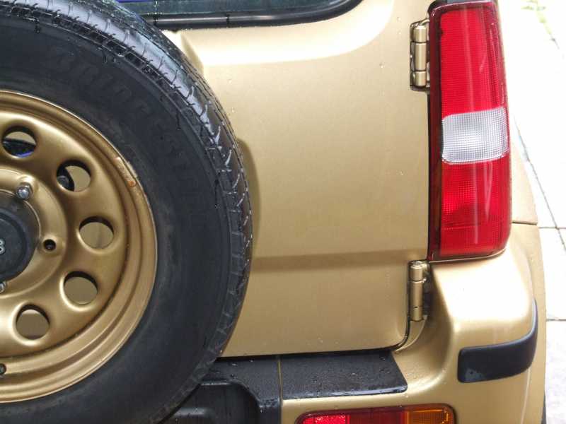

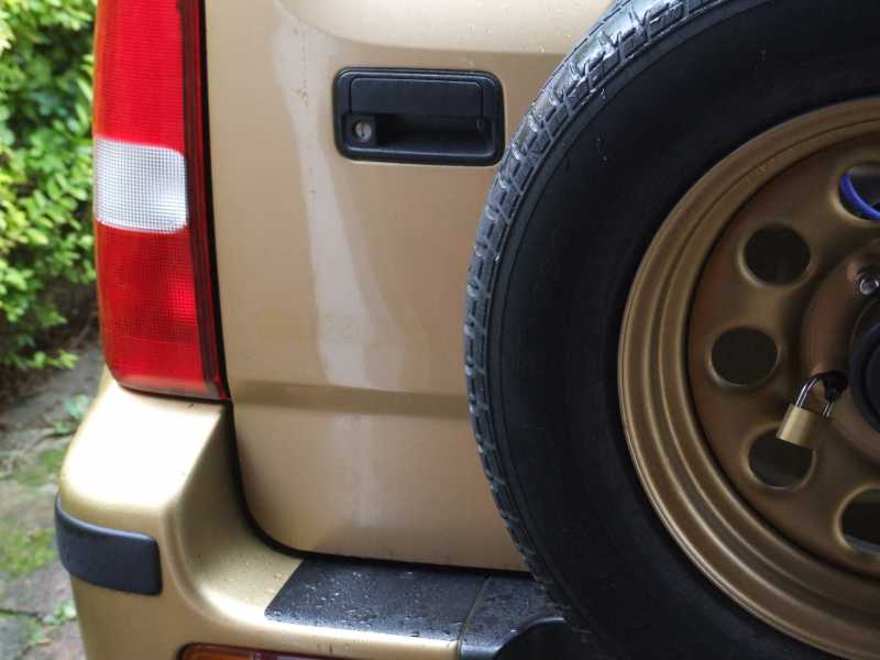

I did the rear badges first. I used kite line to remove the rear badges.
It's an old dodge I learned when they started sticking badges on instead of using clips and such. You need something like fishing line, kite string (better cos it is rough) or string used for ceiling light switches would do (like in toilets). By using a length of say 2 feet you can do a sawing motion to cut along behind the badge. keep your hands in close to the car bodywork, you don't want the string pulling on the badge and buckling it. It removes most of the sticky and the badge comes right off in seconds.
Then I used various solvents to shift the gunk (petrol, meth but not thinners) with the aid of a wooden peg (the tapered end of one half) as a scraper then some T Cut for deep scratches to restore the finish and remove any final weathering lines. Some slight imperceptible ghosting is still there. Take a look
After doing the rear badges

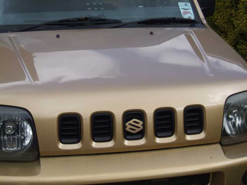

I decided to do the front. Took off the whole trim that the S is on, removed the chrome badge and had intended to leave it black but as the S shape was still there I decided to go for gold and bling it up.
Finally replaced the S with a plain insert.
