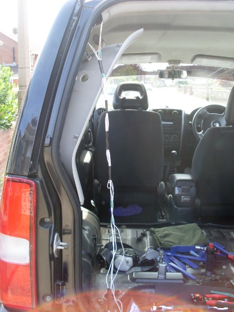

Fitted interior LED lights into the back (turns out to be a bit of a saga)... Was going to use the feed from the interior light but couldn't face the hassle of going under the headlining...Bit of head scratching and decided to splice into the feed to the rear door switch.
To get better access, I unbolted the seatbelt mech...
Cut the wire and added a male & female spade
Then, joined the two lights together in series...
And connected to the rear door switch...
A n d nothing happened...
So reconnected original wires together just to make sure there was power and
then decided to try the lights in parallel....which did work but, not as bright as expected
(I already have the same lights under the wall units in the kitchen!)
So thinking that they may be OK in the dark, I waited and had another look.
Still disappointed but this was better than no lights!
The next day...
After mulling it over, I decided to start again by checking the voltage going to the rear door switch
and it was only 10.4V? I had recently ran a live feed from under the steering column down the right hand side to the rear door to fit a 12V outlet in the back and a switched live to the reversing cam in the back door.
So, I took a feed from the switch across the boot lip to the live feed of the LEDs and
VIOLA!
