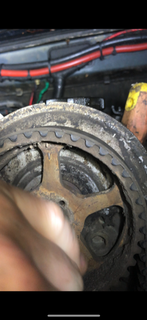

Replied by Basketcase on topic What did you do to your jimny today
Finally found what is potentially the fault with my jimny cutting out when revving it....cam belt seemed a bit slack with about 3cm of play in it...checked for tdc with a trusty screwdriver in cylinder 1 and it’s about 4 teeth out! Have got a video but can’t post em on here but here’s a snaps of it when it’s tdc can’t upload another one where the screwdriver is tdc though

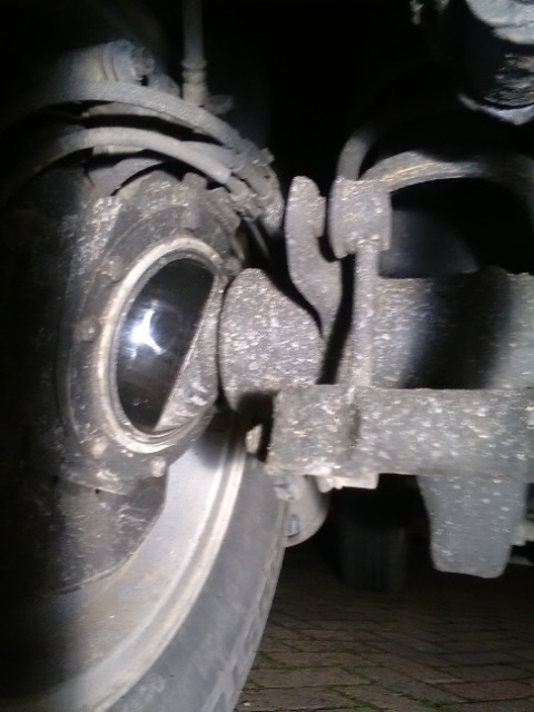

14 Dec 2019 16:54 - 14 Dec 2019 16:56 #216455 by Scimike
Not really what I did today, but over 7 months ago I undertook the replacement of my kingpin bearings and during this decided to refurbish the rusty swivel ball surface. This was simply to give my new seals something better to work against rather than the sand paper like surface the rust provided , it also keeps the water out of my new bearings as the seal can actually seal !!
Well today I took a look at how it's all doing now the salts on the road etc and I am pleased to say it's still perfect. I can't recommend the paint I used enough (POR15) if anyone else hates rust as much as I do.
Picture below is after 7 months daily use:-
Also just passed MOT with no advisories for the third year, so absolutely besotted with our little Jimny.
Have fun
Mike

15 Dec 2019 13:01 #216493 by jackonlyjack
Scimike wrote: Not really what I did today, but over 7 months ago I undertook the replacement of my kingpin bearings and during this decided to refurbish the rusty swivel ball surface. This was simply to give my new seals something better to work against rather than the sand paper like surface the rust provided , it also keeps the water out of my new bearings as the seal can actually seal !!
Have fun
Mike
Thanks for the update Mike it looks like a winner for POR15
Job for next year :)
Jack
