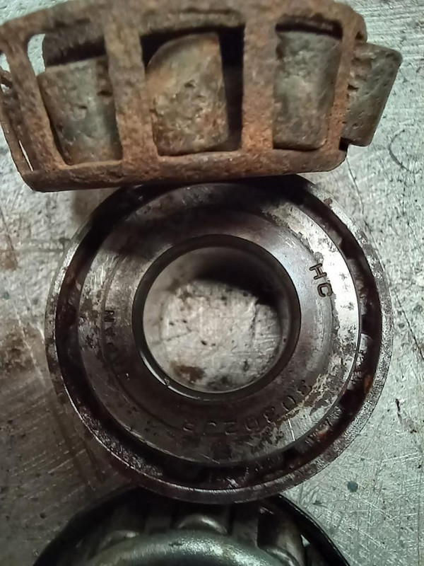

06 Oct 2021 18:10 #239186
by LesNewell
Replied by LesNewell on topic lightweight buggy

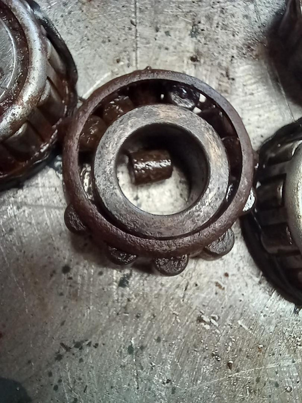

I thought mine were bad when I changed them but you have mine beaten by a decent margin. At least they are cheap to replace.
Use calcium based waterproof grease when you reassemble the king pins. It is more tolerant to water contamination than normal lithium grease. Just don't use it in the CV. That needs black molybdenum disulphide grease.
