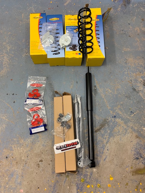

Four standard front springs, four looong shocks from Russ at JimnyBits, spring clamps for dislocating springs, and panhard rod bushes.. to be fitted once the panhard rods have been shortened and rewelded (?)... Ah, yes, I forgot that bit
hence the short side shafts... the axle tubes are going to have 12” cut out of them to make a smaller, narrower buggy, and using two front axles will make the length shorter too...

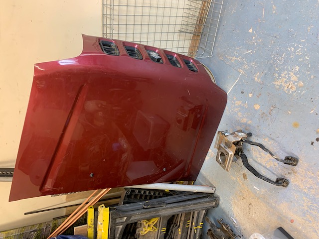

When I went up to James Priestley's to pick up a replacement gearbox for the Boogie, I also came back with -
A burgundy (not for long!) bonnet (s it will be cut down to scale for the lil'bugga), and a pedal box assembly...

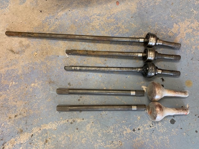

At the start of our latest greenlaning trip Riccy gave me an additional short front shaft in some kind of deal with James, and lent me a long shaft to have a look at and a measure -
So at the top, a long shaft to measure to work out the difference between it and a short one, as that's how much will need removing from the two front axle tubes... The two short sided standard 22 spline shafts for the front front axle
And at the bottom two TrailGear 26 spline HD short shafts and HD CVs for the rear front axle... :lol:
During a WhatsApp conversation with Riccy he pointed out that the rear front axle will turn the wrong way... (and try and tear the lil'bugga apart!) I'd thought about if for a while in the shop, weirdly twirling my fingers trying to work out the rotation of the props, etc. and thought it would work! :lol: But no worries -

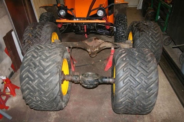

Referencing this old photo from the Boogie build thread, you can see that a Jimny's front diff is high-pinnion, the pinnion is at the top where the prop enters the back of the diff, so I'm hoping I should just be able to flip the diff over, make it low pinnion (more oil for the pinnion!) and that will make the rotation right...
Andy "Baloo" has pointed out on his Lightwight Buggy Build Thread that if you narrow a front axle -
There's not much width left / no turning circle... but look at those MAHOOSIVE tyres! :woohoo: , I'm only planning on going for 215/80-15 Special Track tyres, as it's a small buggy, so everything is to a matching small scale, hence "lil'Bugga" !

The idea of building Little Buggy with 4 wheel steer will give you an amazing turning circle but as has been pointed out you will have trouble with diff. rotation, so I have a few points to consider.
If you turn the diff round to give a low pinion set-up you will/may have the problem of the crown wheel hitting the wall of the diff. housing. This is the part that has the filler plug. You can overcome this by, knocking out the indent, or cutting the whole back plate off and turning 180 deg. and relocating the filler plug.
Or,
Keep the rear diff casing as is and grafting on the hubs from the front axle.
First idea is probably the easiest with the last the hardest. It's all about getting the alignment right.
