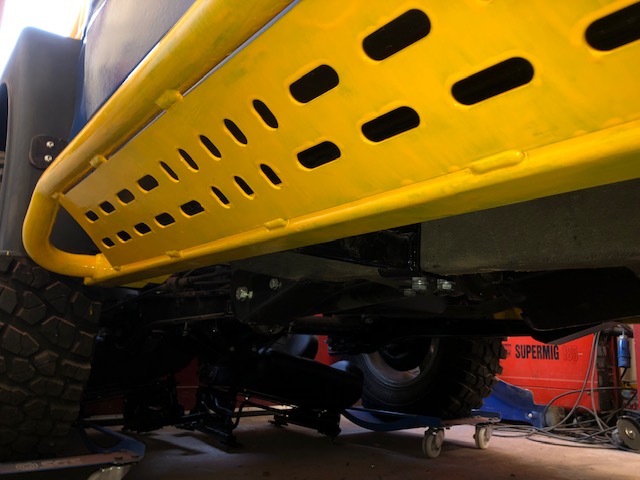

I started by reattaching the newly painted (three coats of JCB Yellow) JimnyBits sidebars...
New fastenings all round... metric fine 12mm and 10mm nuts with oversize washers for the bodymounts either side under the (half) doors, and some new M12s to bolt the sidebars to the chassis brackets, with spring washers...
In front of the doors
Behind the doors
The big chassis bracket
Looking good, and very yellow!
Shame to scratch them?! :evil:
Nice lines too... blue body meets black underseal meets yellow side protection bars :evil:
Behind the doors
