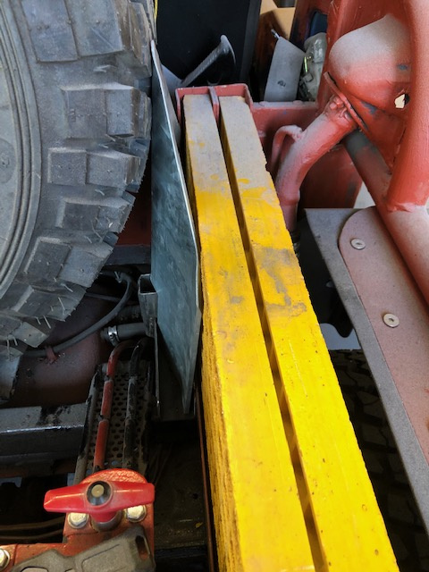

Nice day back in the garage today...
Thought I'd make the mounts for the ground anchor...
Bottom mount on the hoop of the rear 'tray' ?
Top mount on the original soft-top roof hoop and added elliptical stays that meet the top of the rear tray hoop...
So that the ground anchor's handle / shaft mounts nicely here... parallel to the arch and perforated side wal of the tray.
Wing-nit here
And a wing-nut here, make it quick to access... not that I use one much, but you never know...
The a mount for the 'spade' bit... a couple of bits of box section... the bottom U to hold the spade, and a longer upright to go around the central square bar mount...
And then bolts down here... it's tight between the spare wheel's tyre and the waffle board, and a bit of gravity will also hold it in place... once the tyre is ratchet strapped down it doesn't move or rattle...
And that took me all blummin' day!
I had to re-engineer the top mount a couple of times, as the shaft would fit onto the bottom 'peg' but then wouldn't fit on the top mount... got there in the end though, after plenty of eff'ing and jeff'ing... :lol:
