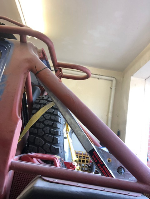

The ground anchor - used to winch off when there's no (pesky) trees around. You winch on the end and the spade bit digs itself into the ground to haul you out of whatever you're stuck in... I've had a few in my time, one similar to this before, one I made myself, and a folding spade one that opened out for use... This is the smaller model that they sell, suitable for Jimnys and the like...
Well made, and nice thick steel, it'll do the job nicely...
I had a good look at the back end to find a suitable mounting point, and ended up...
On the passenger side - the waffle boards are on my side...
So to mount it I figure...
A one inch capped peg through the box section here...
And...
At the top a tube spacer with a thread on the end, through that hole, big washer, wing nut... and another padlock
The 'kink' in the arm ends up here, above the tyre but enough out of the way that it won't foul on the tyre under articulation... That loop hole is used to pull the anchor back out of the ground if it digs in too well! :laugh:
So the anchor arm sits like this ^^^
The spade bit...
Should sit neatly here between the spare wheel and the waffle boards...
Hence why I wanted the anchor now so that I can make the mounts before the final coat of paint goes on
