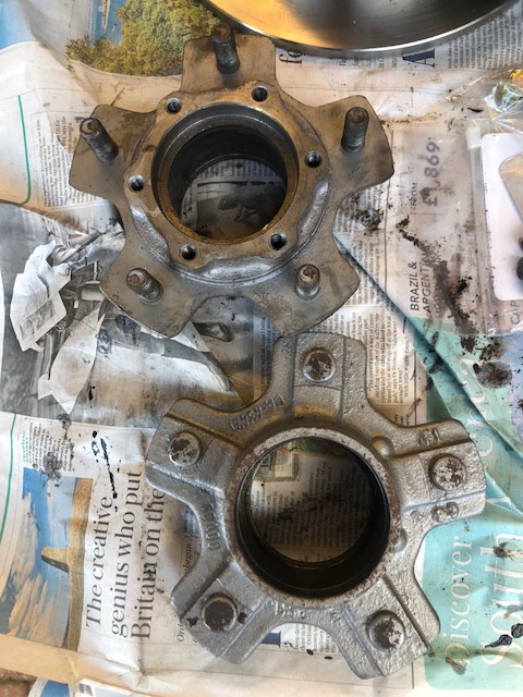

So today I had a spare hour to begin looking at the front wheel bearings... I was supposed to be doing this Sunday, but ended up going out for a "few quiet pints" with an old mate on Saturday night... you can guess the rest!
So I read the writeup on here - www.bigjimny.com/mediawiki/index.php?tit..._bearing_replacement
And began following the suggested steps today...
I popped the oil seal out with a screwdriver, fought with the circlip to free the bearing, and then "two or three swift blows" turned into a damn good beating with a 2lb lump hammer and a bodylift aluminium block! I wasn't as 'lucky' as the original author and it took some considerable force to get the old bearings out...
BUT, out they dd come, without the expense of using a garage's labour or buying a press...

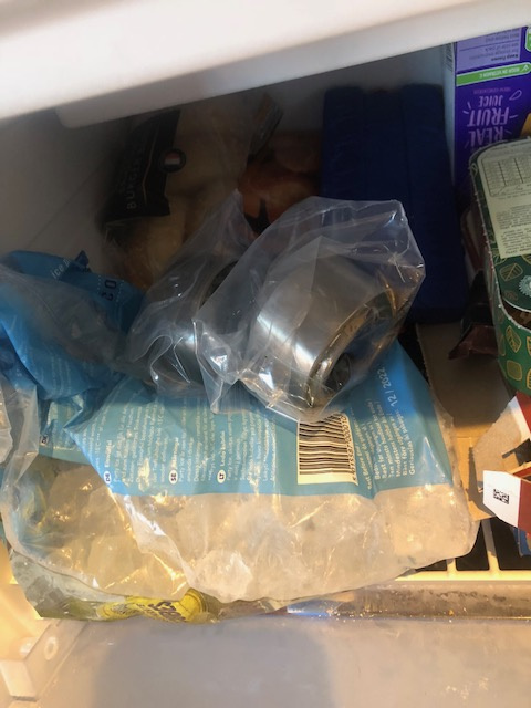

And the new bearings are bagged and in the freezer ready for the next step tomorrow - don't tell the wife!!

Mrs. Dave, Mrs. Dave! He's putting bits of car in the freezer again! Mrs. Dave! :laugh:

:lol: HaHa, you're as mad as me...
m off today so she won't see me abusing the pven
Lambert wrote: Mrs. Dave, Mrs. Dave! He's putting bits of car in the freezer again! Mrs. Dave! :laugh:

Things people do to hide there new shiny parts :evil: :whistle: :woohoo:
