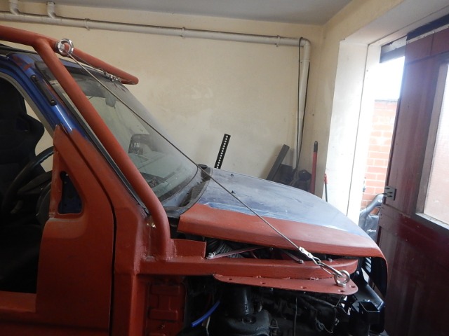

I started with the tree wires as they were fresh in my mind as the lifting rings had arrived yesterday...
So the cable runs from the top of the front wing mount and up through one of the huge rings on the 'halo hoop' of the 'cage'...

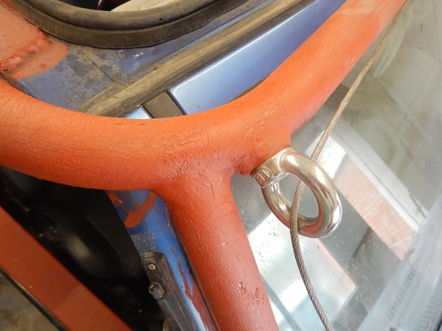

I mounted the ring just next to the A-pillar bar... it's M16 so I cut off the head of the M16 bolt and drilled a hole in the halo hoop and poked the threaded bit of the bolt into the hoop and then popped a washed over the top, then worked out where the thread needed to stop so that the the lifting ring ended up in the right place, and then welded up to the washer to make the shaped mount for the ring...
The idea being that the smaller hook at the top end of the cable (that connects to the turnbuckle in the middle of the halo hoop above the windscreen) JUST fits through this huge ring, so you first clip the cable to the top of the wing, thus -
And then thread the other end through the big loop, and attach it to the turnbuckle, and then when the two are in place, tighten them taught with the turnbuckle...

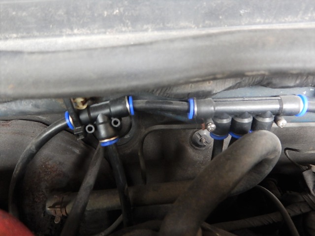

I then made a mounting bracket for the charcoal canister thingamebob...
And with it welded to the top of the spring mount, I painted it and then bolted the canister in place, and then added a BREATHER silicon hose, that leads up to...
An additional T-piece in the breather system...

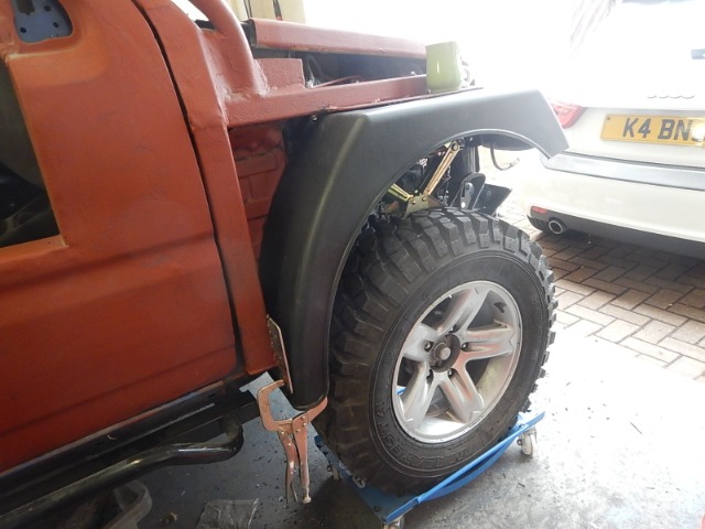

Then onto the front mudguard mountings...
Having..
... adjusted the rear mount to the shape of the mudguard...
And trimmed the front to suit... deciding to go...
Level with the bottom edge of the bonnet / top of the bonnet slam, and half way in relation to the headlight...
SO... that, I think, is the driver's side finished!
Having..
