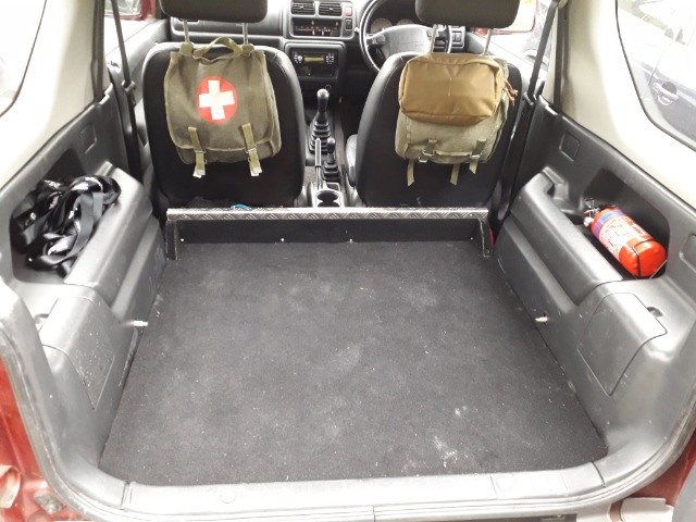

The latest update is that I have had the rear floor cut out and sheet metal welded in, and I have made a floor from marine plywood. I also plugged my vacuum hoses several months ago.

Love the packs on the back of the seats!
Tidy floor job also
Tidy floor job also

Thanks Riccy! Yeah they're pretty handy, got them in an army surplus shop. First aid kit/water in one and warm clothes in the other, just in case the old girl let's me down haha.
