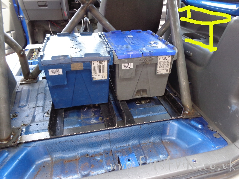

mlines wrote: How about some storage boxes fitted over the wheel arch???
we've got the ARB compressor on the left wheelarch and an entrenching tool on the right :)
