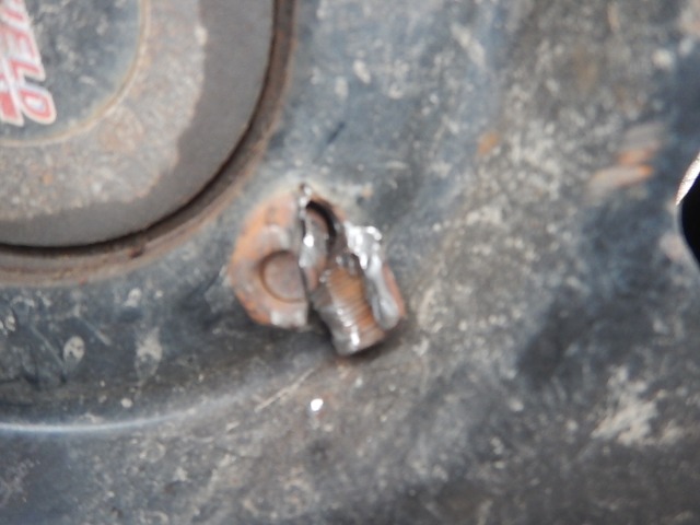

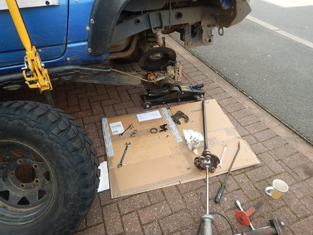

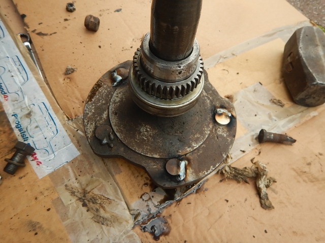

* Brake disc contaminated Nearside Rear -
Ahhh, slight oil leak from the axle making the disk a bit oily... an easy fix then, or so you would have thought?...
Wheel off, disk caliper / bracket off, pull shaft and replace the offending oil seal?...
Nah...! :S
One of the wheel studs was turning in the TG rear HD shaft's flange, another one, I've had a different one do this too!
So it was either weld it in-situ or forceably cut it off!
Enough to get the wheel off and later replace the stud...
Shaft finally out, damaged (whilst fitting by the look of it) oil seal replaced...
New wheel stud pulled through...
And that and the other three remaining un-welded studs then welded to the TG shaft's flange to stop any of them turning and stripping their splines in the flange again...
Reassemble, and submit S200KYS for a re-test, and passed... all history now, but as said at the top of this post, re-posted for the integrity of the build / use thread... and might help someone out there one day?
