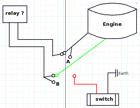

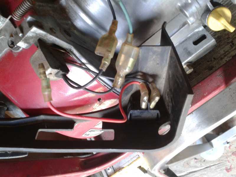

accidentally pulled a lead off the switch on my generator before I'd taken a photo :pinch:
hoping some educated elec technician may know the answer straight away
it's the red wire, can go to either A or B
got a feeling it should go to A, but scared in case I damage something
I'm not sure if it is a relay, it's possibly the low-oil guard module
Help :S :sick:
:pinch:
Help :S :sick:

26 May 2015 13:44 #144846
by Halford
Replied by Halford on topic HELP generator switch
well the answer was A
cleaned out fuel tank, filter and carb and it runs better than the jimny :whistle:
