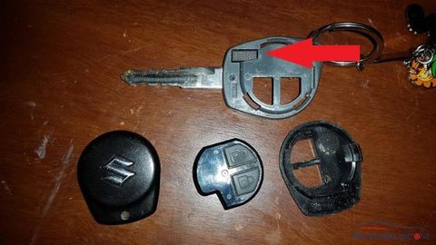

1. The key. This contains a small coded chip in the form of a tiny black rectangle. This is activated by a radio signal and does NOT require a battery. In keys with batteries these are for the remote lock/unlock facility and does not affect chip operation. However when changing the batteries (or renewing the key case) do not lose the chip!.
