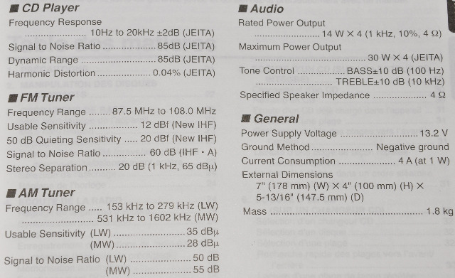

Instead of replacing the factory Clarion PS-2685 2-DIN alike music player, it is quite possible (and relatively cheap) to significantly expand its capabilities:
