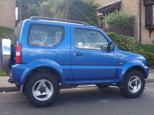

Standard Jimny 3
Standard / stock Jimny 3
  • An unmodified 2005 VVT Jimny 3 (UK) for comparison.

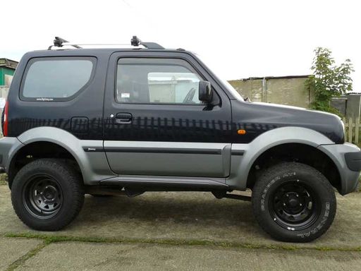

Trailmaster 2" Lift kit
Trailmaster 2" lift and Jimnybits 2" body lift
  • Jimny 3 fitted with Trailmaster 2" lift and Jimnybits 2" body lift combination

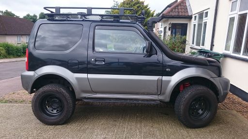

Trailmaster 3" lift
Trailmaster 3" lift
  • Jimny 3 fitted with Trailmaster 3" lift components

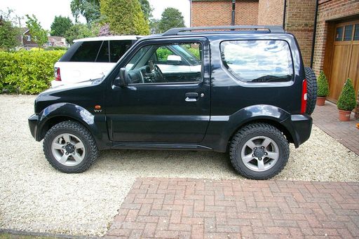

Jimnybits 2" Body lift
  • Jimny 3 fitted with Jimnybits 2" Body lift

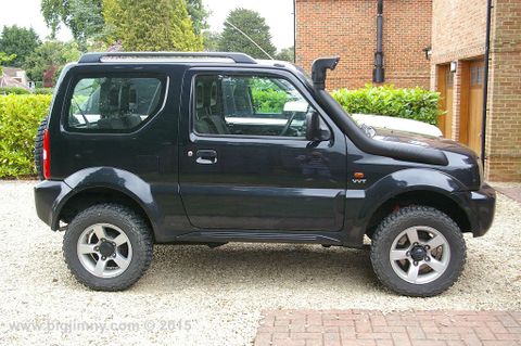

JimnyBits 2" lift
JimnyBits 2" Lift
  • Jimny 3 fitted with JimnyBits 2" lift kit (Procomp shock version)

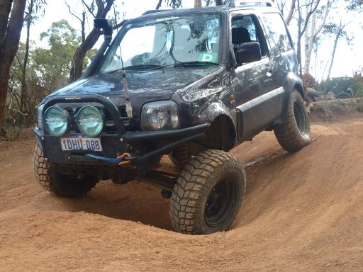

Tough Dog 120mm lift
Tough Dog 120mm Lift
  • Jimny 3 fitted with Tough Dog 120mm Lift (Australia)
  • Note: I think the 120mm lift is an 80mm lift with extra spacers?
