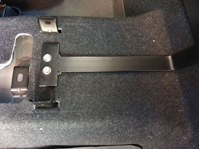

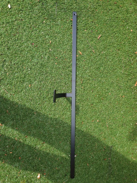

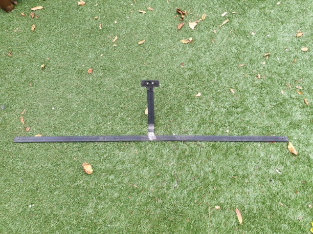

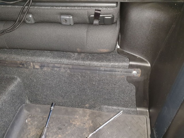

25mm x 4mm flat bar. I ended up using two pieces welded together in the middle. (2 meter length was too big to get home so bought 2 x 1 meter).
Thought it might give too much if only bolted at the ends, so added a central brace.

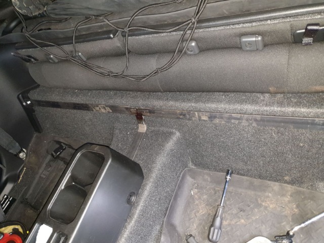

Tie down points removed for now, and bolted in place.
Found a bracket underneath the carpet under the cup holder. It has two holes that are perfect for a couple of M5 rivnuts.
Back from the powder coaters.
Thought that would be better than a painted finish inside the car.
Final fit with tie down points over the top of the flat bar.
2 x M5 bolts in to the random bracket. Just a small notch needed on the bottom edge of the cup holder.

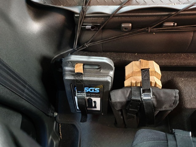

Bottle jack in its case strapped down and folding Zombie shovel with the jack pads next to it. Might get another strap and tie the blocks down separately.
No longer rattling around loose.
