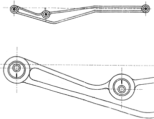

Hi all,
after mounting a +65 mm lift kit now the jimny tends to the left and the caster is -4 /- 5 °, despite I have to fit the caster correction bushes on front control arm
Could the wrong caster be the cause of the tendency to go left ?
thank you and happy New Year
Giacomo

Was the castor bushes fitted correct on both arms
Do you have any bowing in the front springs
